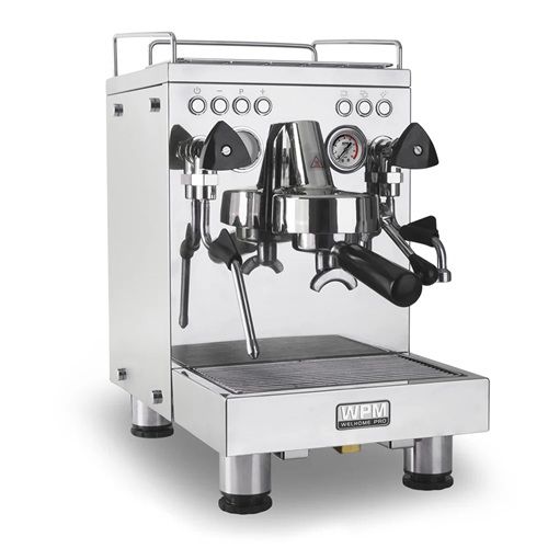

    WPM KD-310P

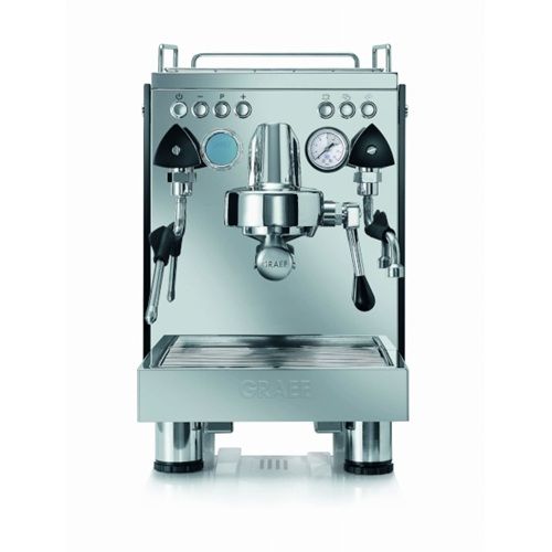

    Graef Contessa ES 1000
